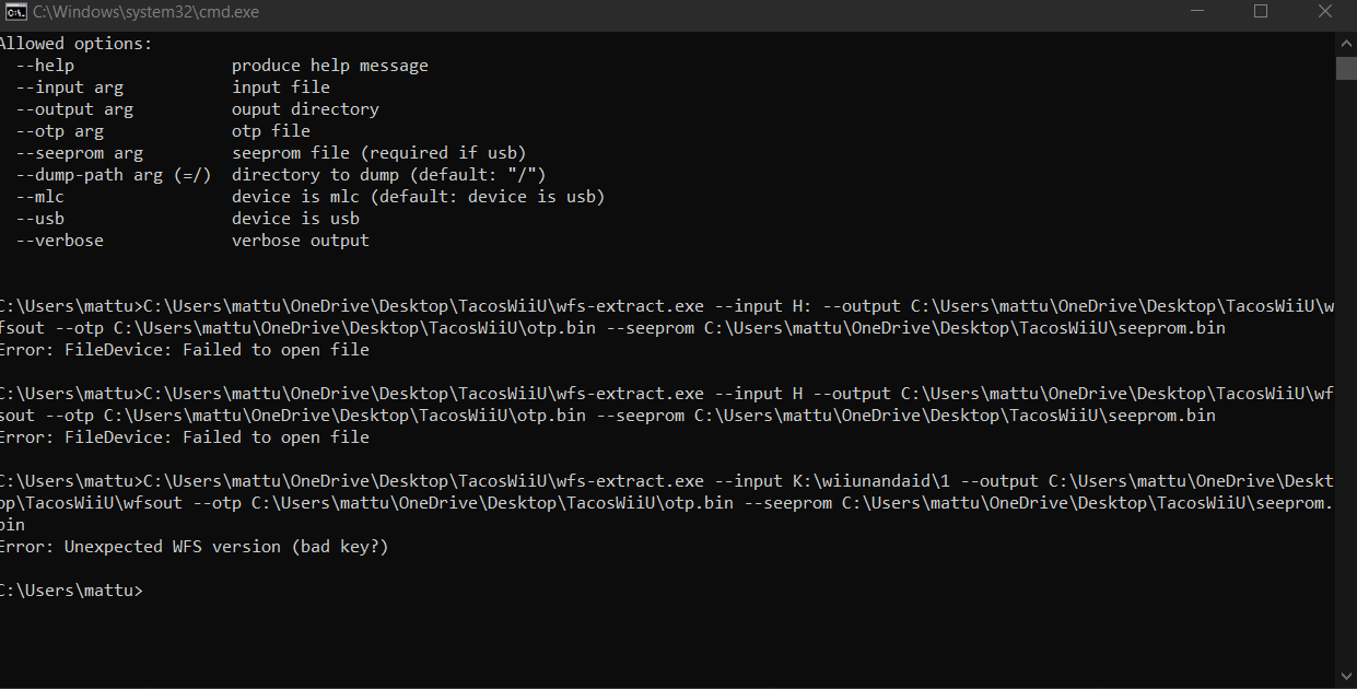

What happens when you try to use wfs-extract against the nand aid SD or the mlc partition for the redNAND?
I haven't done this before, is there a good resource to learn about it?

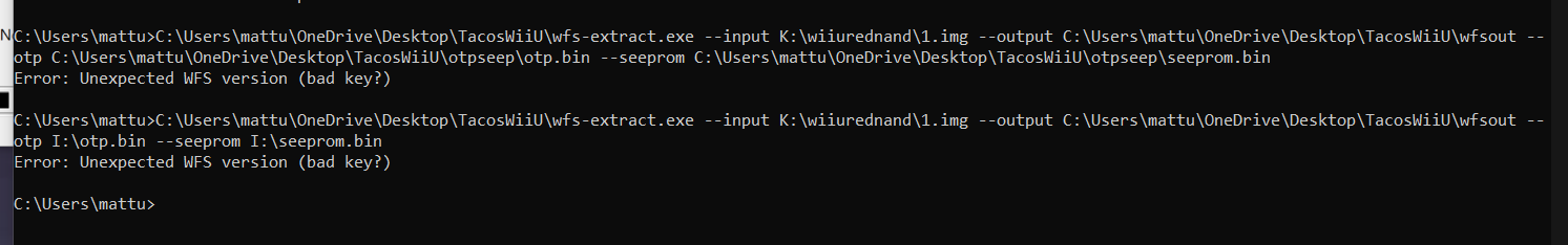

ok I think I figured something out. I used Win32Disc Imager to make an image of the SD card, this is my result running wfs-extract. The first 2 are attempts to read the SD card directly, but that didn't work so I made an image to try that, on the third attempt here:
Any ideas?
Made and image of the MLC of redNand as well. same issue... even checked against our first dump of OTP and Seeprom, before we did ISFXhax.

Just asking cause even the wfs-extract result looks like the cards are damaged/faked but seeing you tried around 6 different cards...

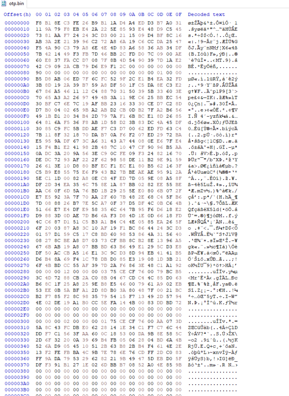

Also open the otp.bin in a hex editor, please, and confirm it's not all zeroes. The thing with wfs-dump might be a bad OTP dump, too...

My opt looks fine in hex

For wfs-extract you need to use the --mlc flag and you don't need to specify the seeprom.
In Windows accessing the raw drives is a little tricky , it doesn't work over the drive letter. You need to access it over the physical device https://stackoverflow.com/questions/327718/how-to-list-physical-disks

Ok I was only able to get a dump of the 128GB card for some reason. Everything else is giving me the bad key error.
What should I look for in the dump?

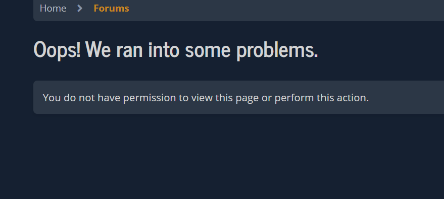

BTW, your link in your profile for the Nand-aid is giving errors:
That's a security feature of GBATemp, see:
In order to reduce scams and for other reasons, only confirmed GBAtemp members are able to access the Trading Area. To become a confirmed member, you must have a minimum of 100 valid posts on the forums. Posts in the Edge of the Forum section do not count towards this, and neither do deleted posts. Do not spam in order to reach 100 posts just to gain access; if you do, your access will be permanently revoked. Once the needed 100 posts are reached, your member group will automatically be changed from "Newcomers" to "Members", and the Trading Area will be listed under the Site Discussions section (in place of the link to this wiki page).
(Source: https://wiki.gbatemp.net/wiki/Trading_Area )
I'm really sorry about this. Had discussions with GBATemp moderators and admins in the past but rules are rules and they won't relax them for me.
can you let me know where to double check for a possible short with these boards
It's a short with the PCB itself and the micro SD slot. This short happens when a card is inserted only through so it's not simple to measure, esp when the slot is not soldered to the PCB.
To fix this I'm adding a small piece of transparent tape to each SD slot before packaging. This tape acts as an insulation layer between the PCB and the slot. So just don't remove that tape and you'll be fine. ;)
Would show you a picture of a slot with piece of tape added but I ran out of tape when packaging the last 3 NAND-AID v3s yesterday for (I guess) you.
//EDIT: Don't get me wrong, all slots I packaged have this added. So yours have it, too. I just don't have any more tape to add it to an unpacked slot and packed ones are shipped already.
