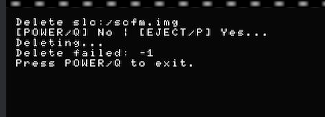

I have a Nand-Aid installed, I up to the section where you delete the MLC and Delete scfm.img but I am getting an error when I delete the scfm.img.
Delete Failed: -1
any ideas?
SDIO
Feb 13, 2023
2,290
28
1,403
Germany
Maybe you already deleted it?
Do you use ISFShax or defuse? In case of defuse, make sure you have a good otp.bin (dumped with PRSHhax)

I am using ISFShax, just following the guide. I will try the next step and just see if the install works I guess.
Well I got through the install but the error for the memory is back
so it looks like nothing changed.
Ok, I was able to delete the scfm.img on the second try, after installing the new Nand files and booting to the memory error.
But I have tried installing the MLC and SLC files and I am still getting the system error, won't boot. What can I try? Is this an SLC issue?
The MLC reads perfectly fine in Recovery Menu. No errors, I also checked to make sure the nand-aid SD card is the new Nand, and when I remove it I get errors on the MLC check.
I think some other part of the memory is the issue, can I try moving the SLC to the SD card and still use the Nand-aid SD card for the MLC?
Updates: I have tried redNand just to see if the system would post. I tried doing just MLC on the SD card, both SLC and MLC, and SLC only. I am still just getting Error code 160-0103. No matter what I try.
Really not sure what I can check next.

Is this what you are looking for? I don't see a file named
wafel_install.log
This is the log for the NandAid install:

Hm that looks all right.
Can you dump the crash system logs? You find the option in the Backup and Restore menu. Just zip them all and snd the whole zip
Sure. This is for the nandaid version. Do you want the RedNand too?

00:00:26:436: User Block Hash Error (Large): 14476672
00:00:26:439: FSA: ### DATA CORRUPTION ERROR ###, dev:mlc01, err:-1245211, cmd:11, path:(null)
00:00:26:481: User Block Hash Error (Large): 14476672
00:00:26:483: FSA: ### DATA CORRUPTION ERROR ###, dev:mlc01, err:-1245211, cmd:11, path:(null)

Maybe the card is bad. Do you use the same or a different card for redNAND?
You can dump the logs for redNAND too.

RedNand is throwing weird errors when I try to install it about the ini file. It wasn't doing this earlier. not sure why now. It doesn't like SCFM being disabled now for some reason.
The Cards are different. I formatted the rednand card in minute. Really I was hoping to use rednand for the SLC only because I suspect it's the SLC, but now I don't know. I am getting errors no matter what.
Now the log is showing error for MLC with RedNand...

The redNAND has exactly the same error, hoe did you set it up sand what is your rednand.ini?
For the warnings in the installlogs: it just means the folders couldn't be created, because they were already there. Format the rednand partition on the PC, to make sure the Wii U formats it again.
I have tried multiple ini settings. The ones in the guide are throwing the error.
I have gotten it to go through before though. I just removed the extra partitions and made one big NTFS partition and will try to install that way.
Update: After clearing the extra partitions and making one giant NTFS partition, I got no errors and I have started to install titles again.
Here's the logs for a good redNand install, yet still memory error.. could the SD Card slot be having issues? I can get most things to work so that would be weird.
  • Good redNand install logs.zip

43
84
maybe the sdcard you are installing to has a problem. The install itself looks good.
going to try another SD card, but the Nandaid one is brand new so I hope not.
Tried another SD card with rednand, exact same issue. I am starting to suspect the SD card slot on the system is having issues. I had to remove the spring because the locking pin not working. ...
So I have tried 4 different SD cards with both installs now. It's got to be something else. Both Nand-aid and redNand continue to have the exact same outcome. The system loads to the wii u logo, then the screen goes to the memory error.
I put a 128 GB card in the Nand-aid and deleted MLC, it took twice as long as with the 64. The card shows as full and needs to be formatted on PC after install.
No idea why this system is stuck on this memory error. It has to be something other than the MLC that's the issue.
I'm curious if it's safe to completely remove the old nand chip, just to rule out that some sort of connection is happening with it?
I've also ordered a new SD card slot to try and swap that out.

try to use the unlimit plugin without rednand and see if that changes something.
What brand/model are the sd cards?
