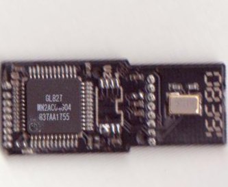

There are only certain SD card readers confirmed working with this mod for 3DS XL:
Anker® USB 3.0 (68UNMCRD-B2U) : Realtek RTS5306
TekRepublic TUC-300 : Realtek RTS5307
SanDisk SDDR-121-A11M : GL827
Transcend P8 TS-RDP8K : ALCOR AU6476 (Thank you Gamerquest1 and zchtoy)
Anker® USB 3.0 4-Slot Card Reader (A7612) : RT5301 (Ava)
(The "Anker" readers have been highly tested by me and others who have performed a hardmod. They are confirmed to work with the Old 3DS. Therefore, the "Anker" readers are best recommended to work with this hardmod)
It does Does not actually work for the N3ds XL, unless I'm doing it wrong.
When I plug it into the computer, it makes a sound as if I plugged in something, and shows up as Disk F: But when I click on it, it says that I need to insert a disk into Drive F.
ALso, win32diskimager does not have a drop down selection.
I MAY have it improperly hooked up onto the adapter, but I am pretty sure I got it correct.
The adapter that I got was purchased from the link in the first post and also has the same serial number on the outside packaging. The "chip" is just a black blob with no numbering, so there's really no telling if its the same GL827 chip or not.
I took it apart again just to try a different random adapter, a Samsung adapter with the Realtek RTS5153 chip on it, hooked up the same as the SanDisk one, and I do not get the sound as if I've plugged anything in, and literally does not work at all.
Here's how I have the SanDisk wired up but on the samsung one that does not work:
(the pins look like they are touching, but trust me, they are not)
Green = Dat0 Brown=Gnd Red=CLK Yellow=CMD
EDIT:
I found out what the problem is.
Heres a REAL SanDisk A11M:
Here's what I got:
Clearly a fake. Already requested a refund.
