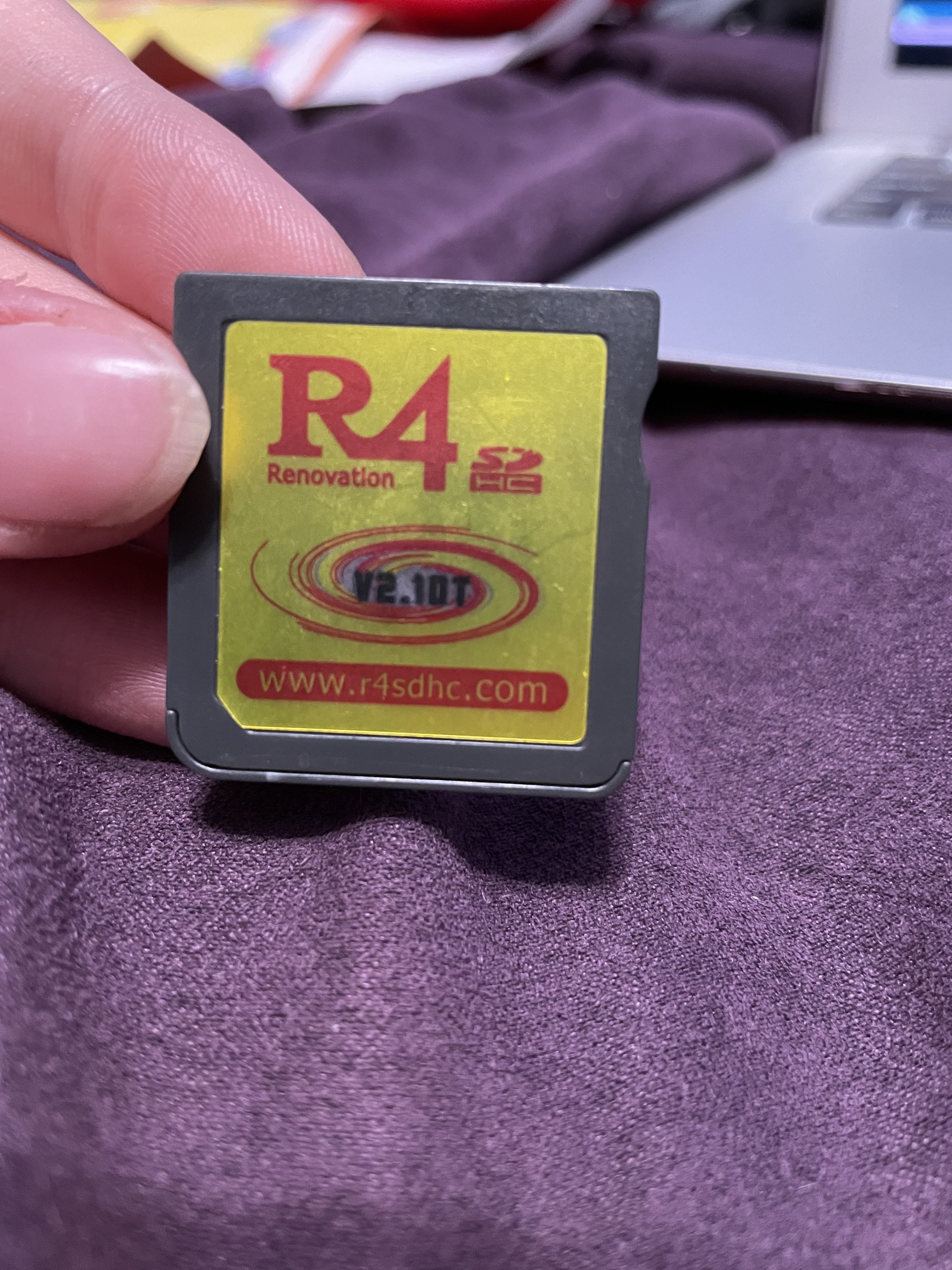

The one I have is similar (R4ISDHC RENOVATION 2.20T), it is not compatible with anything that isnt the original kernel and executable on the boot level (which is awful since if I hadnt found years ago the original kernel and made a copy it would be lost to time, since the original site doesnt exist), but if you copy the YSmenu files and try to boot the YSmenu.nds, it works (meaning that primary booting is not possible).
What you can do however is to give a quick access to YSmenu instead of seeking the YSmenu.nds on the game list everytime.
If it includes a Multimedia icon and Moonshell you can replace and rename the moonshell folders to the ones on YSmenu (I think I renamed the YSmenu.nds to moonshl2.nds), so when the flashcard starts, instead of clicking on the Game icon, you click on the Multimedia icon to load YSmenu quicker.
This flashcard had only one update on its lifetime to support DSi system update 1.4 and that is it. The original kernel works but has issues with games released later on the DS life like Pokemon BW2 and the most recent Yu Gi Oh game on the DS which I dont remember the name. With YSmenu all games work fine, even romhacks and translations, contrary to some posts saying that the original kernel in their flashcards is better.
Do you happen to still have original kernal? I have a R4 SDHC Renovation 2.10T and I haven't been able to find the kernal anywhere. I found this R4 SDHC 2010 firmware on this site by a user called Randall69 and it works in the sense that I can play games before 2010 on it, but anything newer, like Pokemon Black/Conquest, and I get a dldi error when trying to use YSMenu. I'm gonna give what you said a try though.
The original kernal on mine was time bombed and some files got deleted when I was younger. I've been trying to make it work on my v5 DS Lite. I also have a TTDS card too that still works but it also can't play any of the newer games. (haven't tried updating the kernal/firmware yet though) Also, in order to even be able to play ANY games on my R4 SDHC clone, I discovered I had to do a weird mix of files (3rd photo). I had to combine the regular R4 SDHC files with the clone one from RetroGameFan's multi cart update. The original files that I do have still are in the 4th photo, (I do not have the R4i Menu that came with it though where the ButtonLIB and RTS files were originally). Additionally, the DEMON.sys and DEMON0.sys files, along with the SWRESET.sys file, recreate themselves if I delete them and put my R4 back in my DS Lite.
I'm at my wits end on trying to get rid of the dldi error when I launch games in YSMenu.

On the r4sdhc.com are you using a non-SDHC card? (2 GB or smaller) It's possible that could cause a DLDI error, I know some DLDIs don't work on SDSC.
And just to be sure, have you tried deleting everything from the old kernel and using the files from the R4SDHC folder of this? It does say that website should be supported from that folder, though it's possible they made multiple non-intercompatible carts.
The DSTT should for sure work with YSMenu and support the newer games and such. That's probably the better cart so if you only need one working I'd try that.

On the r4sdhc are you using a non-SDHC card? (2 GB or smaller) It's possible that could cause a DLDI error, I know some DLDIs don't work on SDSC.
I'm pretty sure it's a SDHC Clone and the micro sd card is 2GB. I know a long time ago, Pokemon Black did run on it once but then it froze and couldn't progress story anymore.
Yup, I tried deleting everything from the old kernal and using the R4SDHC folder. Yeah, like, I can get YSMenu to launch but I just keep getting those DLDI errors.
Yeah, I was hoping to give my boyfriend one of the cards and then we could play a bunch of the Pokemon games together but I might just buy him a new card and I'll continue to use the DSTT once I update it.
Thanks for replying back!
I meant of the SD card was non-SDHC, not the flashcard, which since it's 2 GB it is. Try using a 4GB or larger microSD in that flashcard if you can, it may fix the DLDI errors.
https://gbatemp.net/download/r4isdhc-renovation-v2-20t-kernel-and-ysmenu.37425/
It is the original kernel and it has the moonshell replaced by ysmenu, so you can boot games on the original kernel by choosing the game option or if you click on the Multimedia icon it goes to ysmenu.
IT WORKED!!!! Thank you so much!!!!! I ended up putting it on my newer 64 GB SDHX card that I formatted to be a Fat32

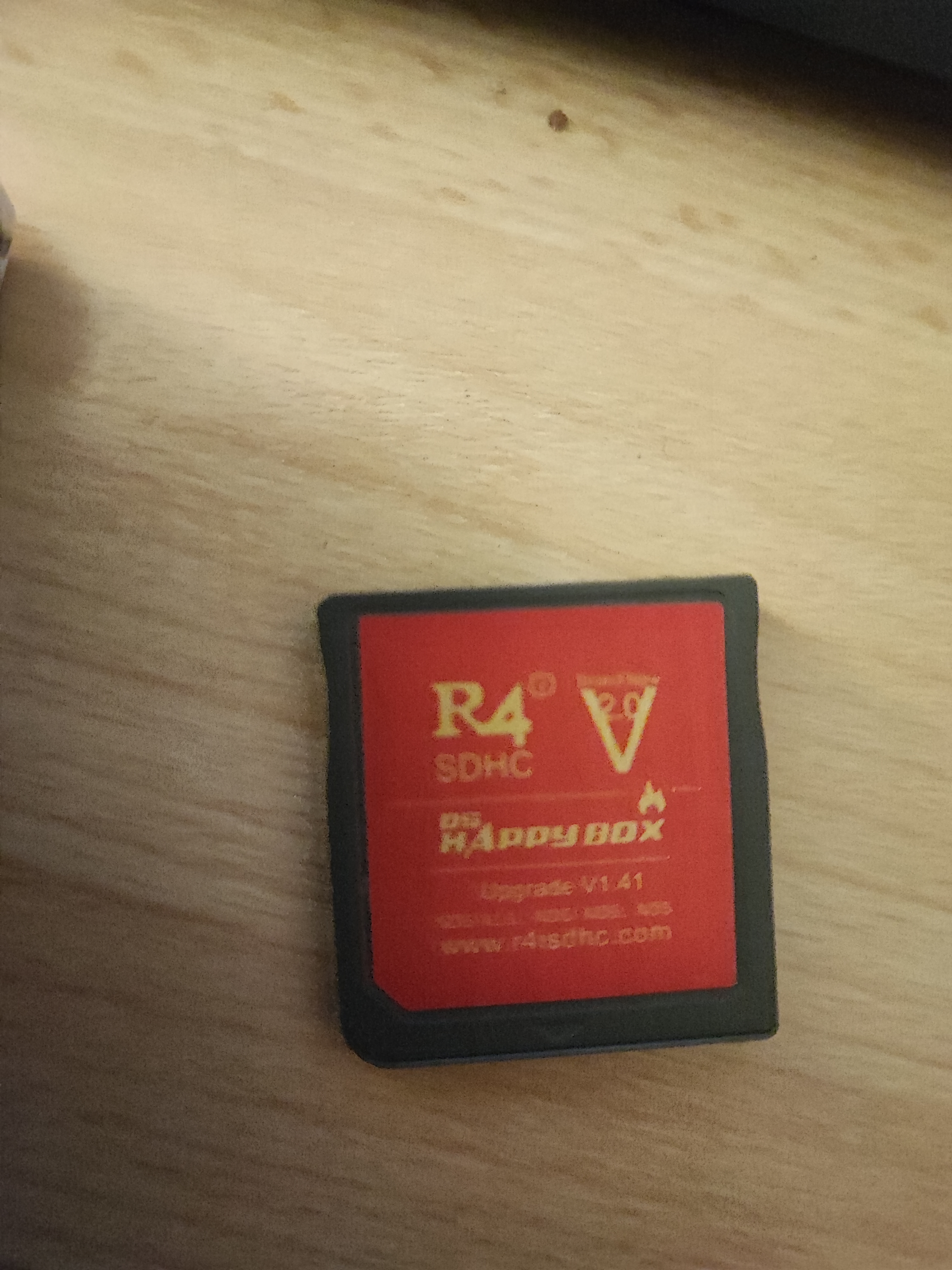

Hello, I'm looking for help.
I have this R4i Gold: Front / Back
I got a file named r4igold_wood_v2.50.rar using Wayback Machine, this is the latest official kernel released by www.r4igold.cc for the R4i Gold Wood. There is another update R4GOLD2.6_EN.rar, this didn't work with the R4. I get a Black screen with Loading.
I tried using instructions for different flashcarts but none of them worked. Does anybody know how to make this work? I'm interested in using the most up to date kernel but none seem to work. :(
When I power on the DSi XL I get a DORASU game with a little kid. If I don't configure the DS Lite to boot automatically to the flashcart it won't be recognized.
My root folder looks like this:
_system_
moonshl2
moonmemo
_ds_mshl.nds
_ds_menu.dat.
_system_ folder looks like:
skin (folder)
usrcheat.dat
strings.txt
savesize.bin
romlist.dat
r4.dldi
font.bin
euc-cn.bin
Hope all of this information helps you on helping me. Thank you!
