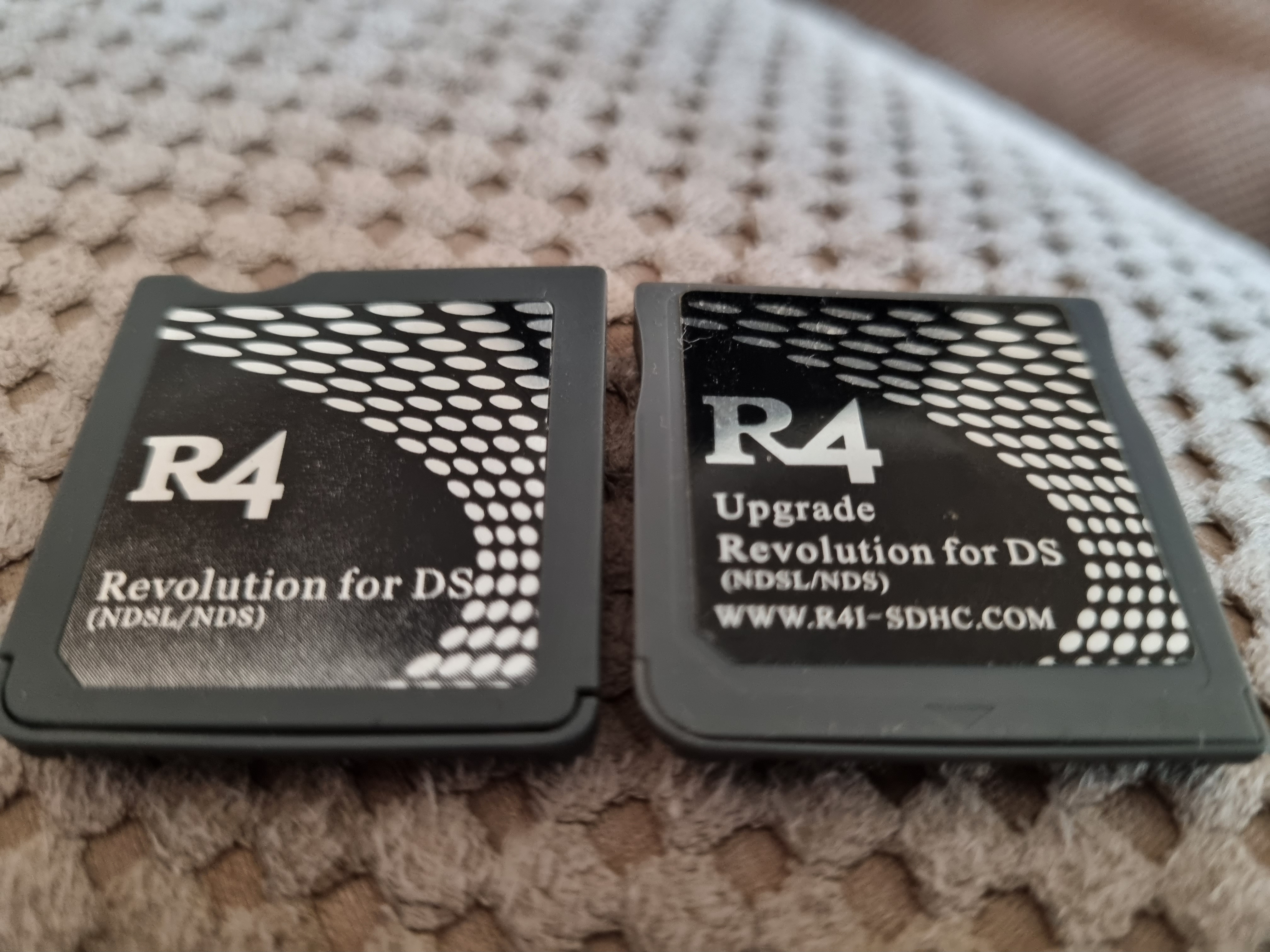

Hey. Found two early R4 cards that I'd like to update to get working again. Can you tell me which software/firmwares will work this them?
Pk11
A catgirl with a DSi
Jun 26, 2019
1,285
22
米国
xn--rck9c.xn--tckwe
3,910
Left one looks like an original R4, so Wood R4, note that you'll need a 2 GB or smaller microSD though.
Right one should be YSMenu (this), specifically the R4i-SDHC folder.

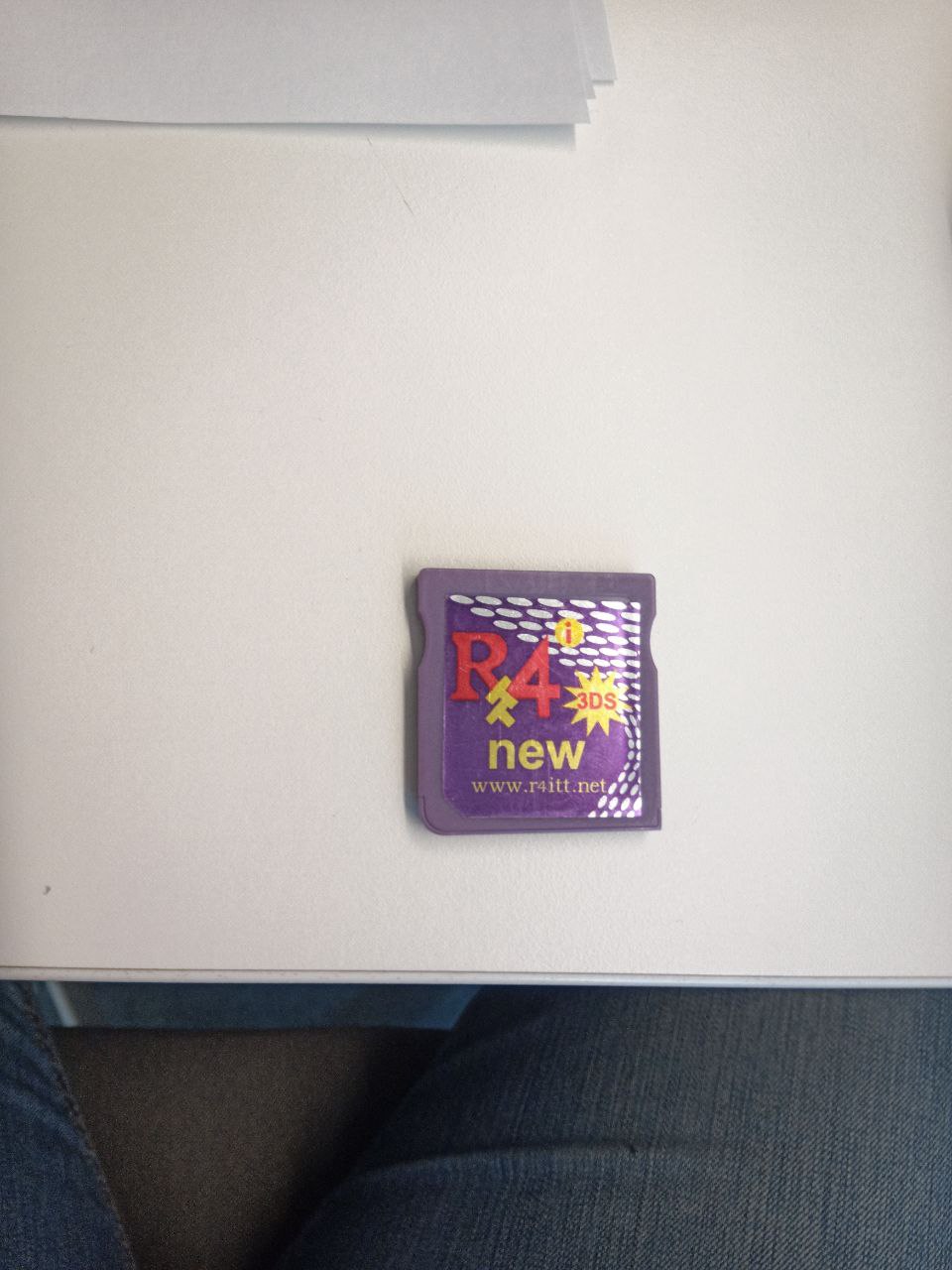

hello i couldn't make it work for this card. i tried dstti but I didn't work. is this suitable for ysmenu? if so, which file should I go with? thanks in advance!
lifehackerhansol
i write working(?) code
Oct 2, 2021
468
1,449
Reactions: havhav31

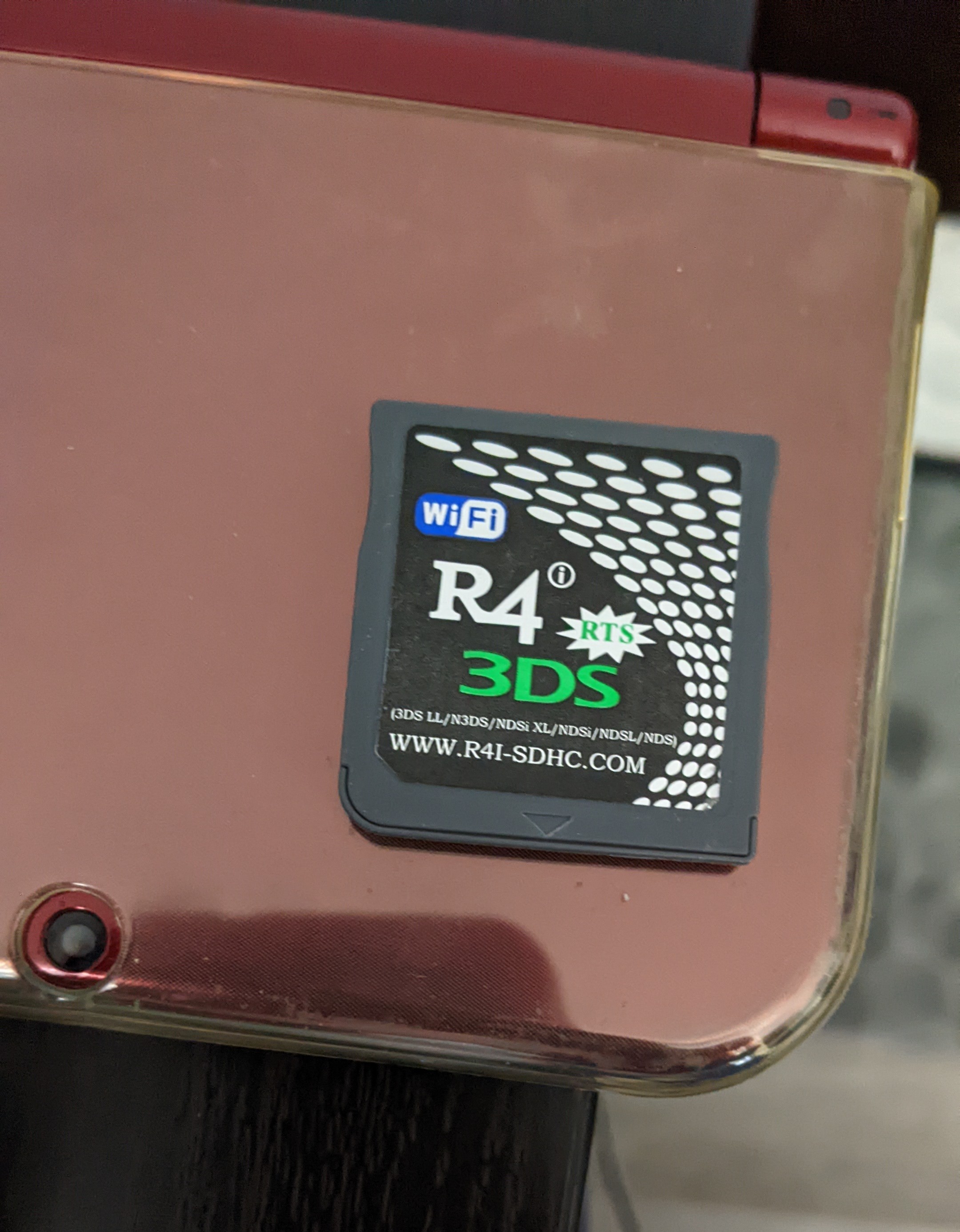

Hello, I recently got an r4i for 3ds, followed the steps for r4i-sdhc like it says but for some reason the chip doesn't seem to recognize 3ds games when in the 3ds. I can play ds games but 3ds games don't show up in the menu. I tried Dead or Alive Dimensions but it wouldn't show up in the menu. Advance Wars Dual Strike worked so I assume there must be a problem loading 3ds games on my end.
I've tried following the primary kernal instructions, then tried following the dual boot instructions, then tried just using the r4i kernal from the manufacturer website but none of them worked. Is there a problem with my chip?
Heres the card I'm using. MicroSD is is a fresh 32gb sdhc from best buy

Hello, I recently got an r4i for 3ds, followed the steps for r4i-sdhc like it says but for some reason the chip doesn't seem to recognize 3ds games when in the 3ds. I can play ds games but 3ds games don't show up in the menu. I got the 3ds rom from -snip- and tried Dead or Alive Dimensions but it wouldn't show up in the menu. Advance Wars Dual Strike worked so I assume there must be a problem loading 3ds games on my end.
That's normal. DS flashcards do not support 3DS games, the "3DS" branding simply refers to that they work on 3DS.
To use 3DS ROMs you'll need to install CFW on your console.
PS you shouldn't link Warez sites as per site rules.
flameConvoy
Sep 25, 2022
4
26
washington
34
my mistake, thanks! I should have noticed that when I bought the card. I'll look into sorting my 3ds out.
