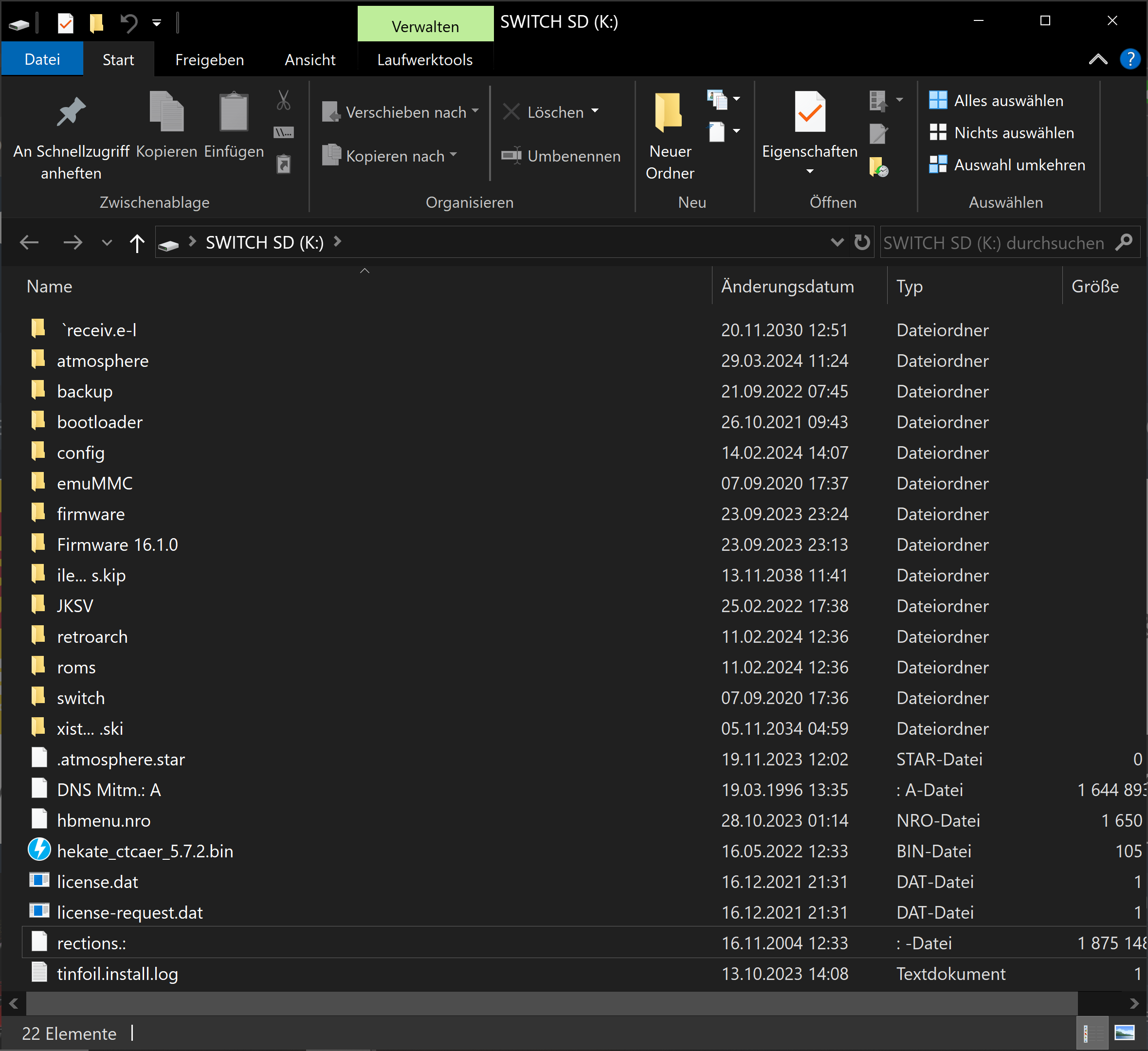

a short summary of what happend: my son clicked on "update" instead of "start software", the switch crashed, i could not get athmo to workl again, package 1 error.
iam just reinstalling athmo 1.7 and i found some wierd files on my SD card.... any idea whats going on?

Filesystem corruption. It may be fixable by formatting the microSD card, but it can sometimes also be caused by a failing microSD card. You can take your chances with continuing to use it, but personally, with how cheap microSD cards are these days, I'd opt to just replace it, and maybe relegate this one to something where data loss is a bit less of a worry.

well i had some more trouble today:
i put the micro sc card in the cd card slot for a second,
after that....all files gone i think, pc didnt show cd card.
but i could still inject payloads via auto rcm.
fusee toald me to fix bit 1 ,
i injected hecate, it only showed me tha lite version.
i fixed bit 1.
but now all files are gone..... and it seems so is my emummc.....
guess without a proper back up my saves and installed games are lost right?
edit: HA! i wanted to create a new emummc via hecate BUT could restore the old one .... now i only need to get everything to work properly again
