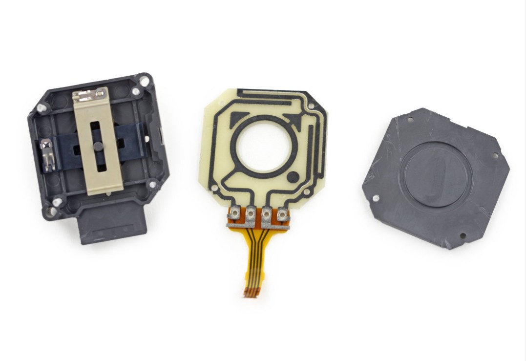

The Circle Pad and the Joycon stick actually share a lot of similarities - you'll notice familiar X/Y wipers on a carbon trace, just like on a Joycon. The wiper assembly seems more robust, but the principle is the same - match and matchbox instead of rotary potentiometers you usually see. This is much more akin to a volume slider than it is to a traditional stick, I'm not surprised both are quick to fail.
The issue with the circle pad was a completely different one though. The circle pads just had their top piece (with the stem) break off or the rubber piece rip off.
The 3DS circle pad was also low profile like the Switch, so it's bound to have limitations. Just not sure how they could outright solve the problem without making the JoyCons thicker. They might be able to make improvements, but ultimately they will likely never be as durable as full size sticks.
Circle Pad drift is not uncommon, you see cases pop up every now and then, although admittedly the cap is simply less durable than the wipers themselves, so you see it fail long before the internal components do. Nintendo did fix it eventually by hardening the stick material, and the force distribution is a little different in a slider, so they stack up as more reliable, for sure.
It certainly doesn't seem as common as it seems on the Switch, I hear reports of it all the time on Switch and don't remember hearing about a single one on the 3DS. Even though I watch repair videos on YouTube where people buy random lots of faulty consoles and repair them, I've never come across one that showed a circle pad with drifting, and I've come across at least 10 Switch ones.
What I have come across though are ones where the circle pad is just permanently registering in one direction. They're not very common, but they happen.
The Joycons use wipers the just like the 3DS circlepad, which isn't a problem on its own. Now add in the button that requires pressing the analog stick inward, unlike the 3DS, and now the wipers have tension placed on them laterally and longitudinally, which bends the prongs.
With the stretched out prongs reaching farther across the PCB traces, the prongs are now outside of the 'deadzone' set by Nintendo and is interpreted as user input instead of a new 'at rest' position.
That is true. And I think some people may just put too much force on the stick while they're playing, which wasn't so much of a problem because it was held in place so that it couldn't move much on the vertical axis.
But the material the pads on the JoyCon sticks are made out of seems to be the main problem. I don't know if the 3DS circle pads used the same material, but it looks like some sort of graphite material and wears out really easily.
On the 3DS the circle pads weren't known to wear out until Smash 4 was released. But on the Switch, they seem to be guaranteed to wear out over time no matter how careful you are. That graphite looking material will wear out, it's just a matter of how rough you are whether it will wear out in a year, or several years. My cousin doesn't seem to be especially rough with the JoyCons when he plays, but he's had his left JoyCon replaced once, and now it's experiencing the same problem again, all in less than 2 years after first getting the Switch.
The root cause of both faults is the same - the stick is "sticking" to a value. That is, unless a part of the assembly straight up broke off and no longer moves. :P They're definitely less common though, I'll give you that. Sliding the slider back and forth must put less stress on the carbon traces and the wipers than using the stick, which makes sense. Alternatively, they changed the carbon trace material to something softer and the wipers just tear right through it.
