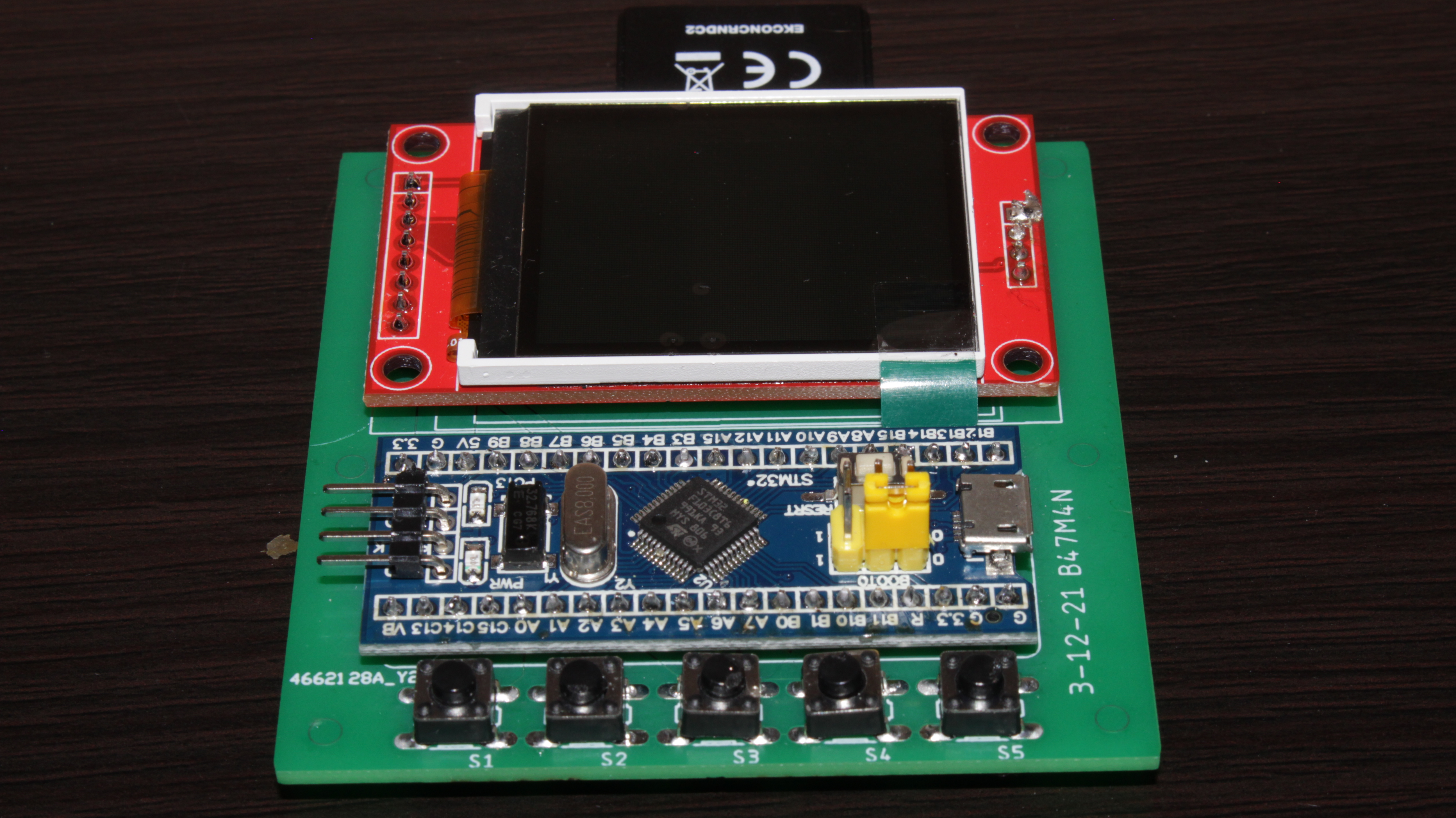

Project D.I.R.E. (Disney Infinity Reverse Engineered) is a portal emulator for Disney Infinity, Lego Dimensions, and Skylanders. This replaces the original portal in place of a custom created one to inject your own character dumps without the need for the original characters, vehicles, or playsets.
This emulator originally started several years ago after a talented coder named obiima did not release his project to the public. Obiima created and demoed a console portal emulator for 3 games: Disney Infinity, Lego Dimensions, and Skylanders. Obiima never released his project into the wild and the project he did release privately was closed firmware meaning locked to the stm32 Bluepill. This project picks up where he left off.
The Firmware allows this device to select between games by holding one of the buttons during boot. Specific Button usage can be found in the User Guide. You have the option of using limited onboard memory or by using an SD card you can increase the character count in your base emulator. By adding your own character files known as bin files, you can inject them into the game without having to keep your original characters.
This emulator currently works on the Wii, Wii U, PS3, and PS4.

Ok maybe someone here got a solution cause i am out of ideas.
One time the pcb will load up correct, and most of the times it won't.
Then it says: Windows doesn't recognize this usb device.
And all i get is a white screen on the pcb
Flashed it all, and same for the bank.
It doesn't recognize the sd card? Its a 4gb but used the 128.raw file to make it lower...

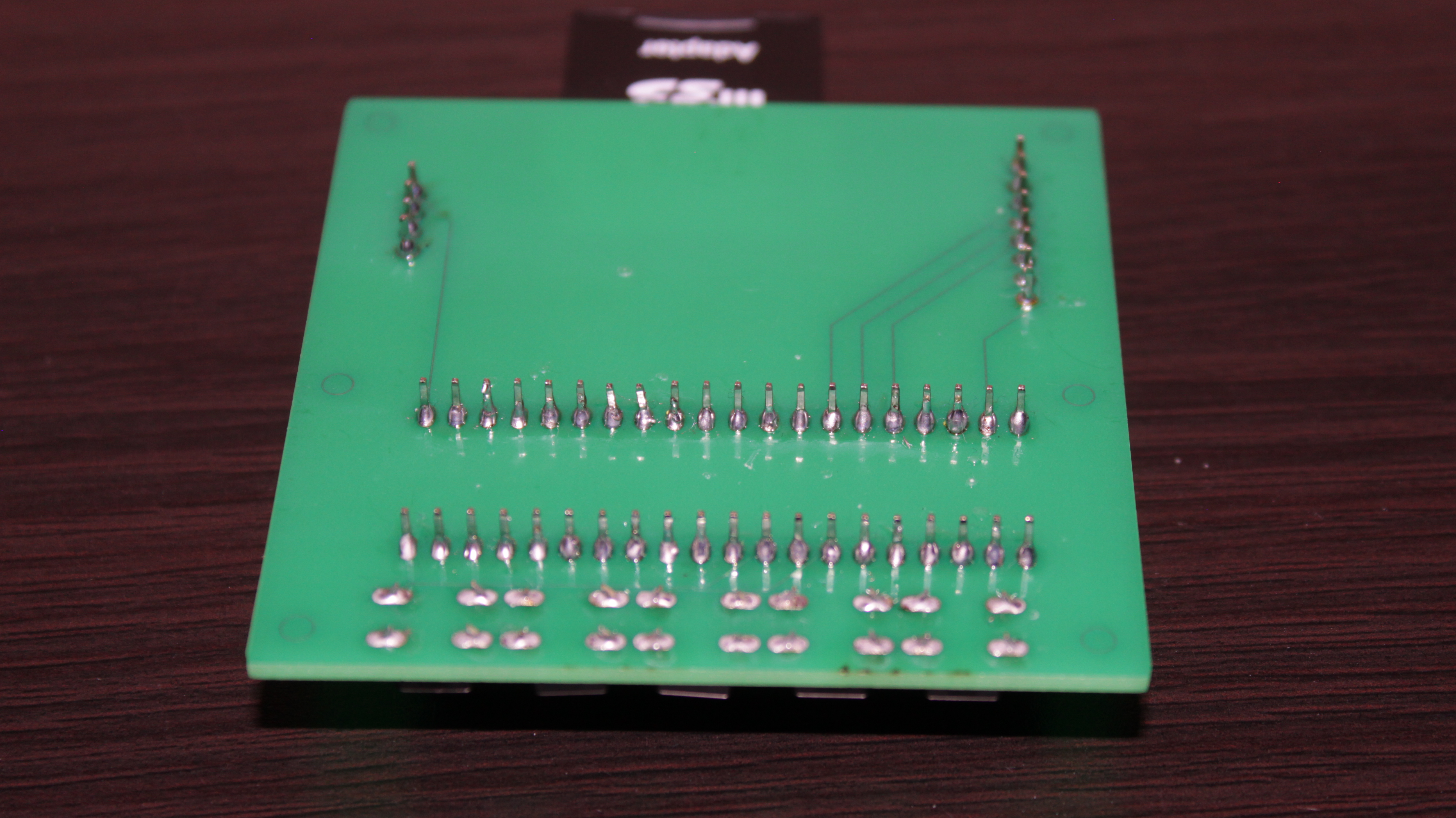

1. You should check all your solder joints.
2. Make sure the sd card is pushed all the way into the slot
3. Try a different USB cable
4. Reflash it using the st-link again only connecting the st-link and your bluepill
5. Double check your bluepill is 256k not 64k
Thanks for reply. But i just got to wait for new parts sadly... I resoldered some parts and attached it with usb and suddenly a small part gave a smoke signal.. Kinda dead now the parts....
But still will reply:
1. I checked solder and all looked good.
2. I did till i heard a loud click, and couldnt push it further
3. Tried 4 cables, and only 1 did "work"
4. Tried that many times before to
5. The bat file said it was a 128 or 256k stm. So my guess it should be big enough to store the "firmware"?
Only got to wait now for new parts to arrive and going to try again...
