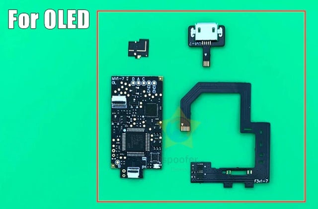

i just bought it from alixpress. i have it installed and running perfectly. Does this modchip need to be upgraded to v 0.2 anymore?

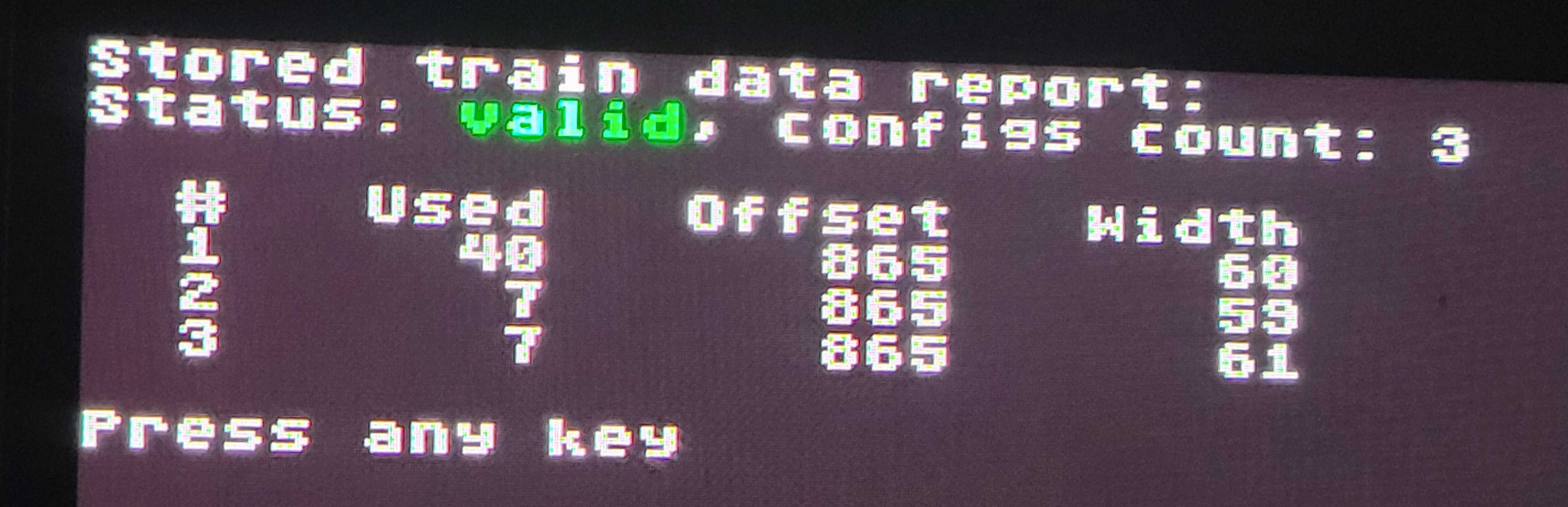

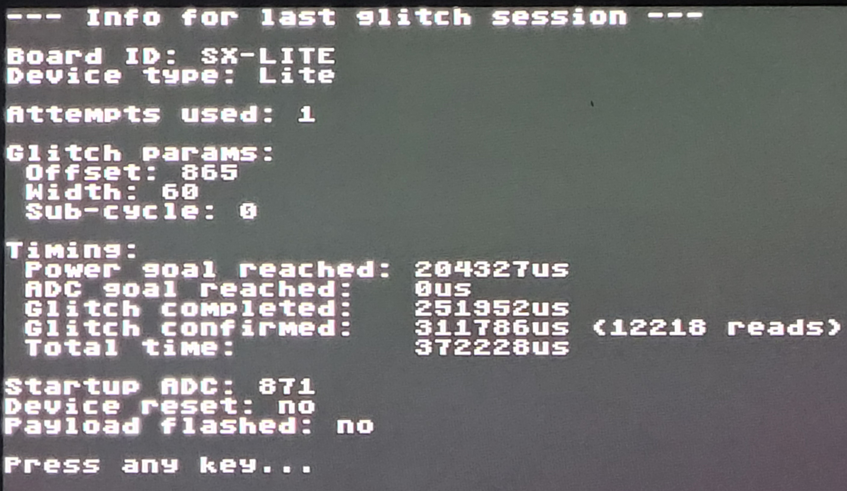

This new 0.6.1 release is perfection, it trains very fast now & consistently finds the best glitch offset for my Switch.
In order to get all the features it's most likely best to flash both the bootload & firmware on PC by hooking your chip up to your computer by USB.
Reactions: Quezacotl and FR0ZN

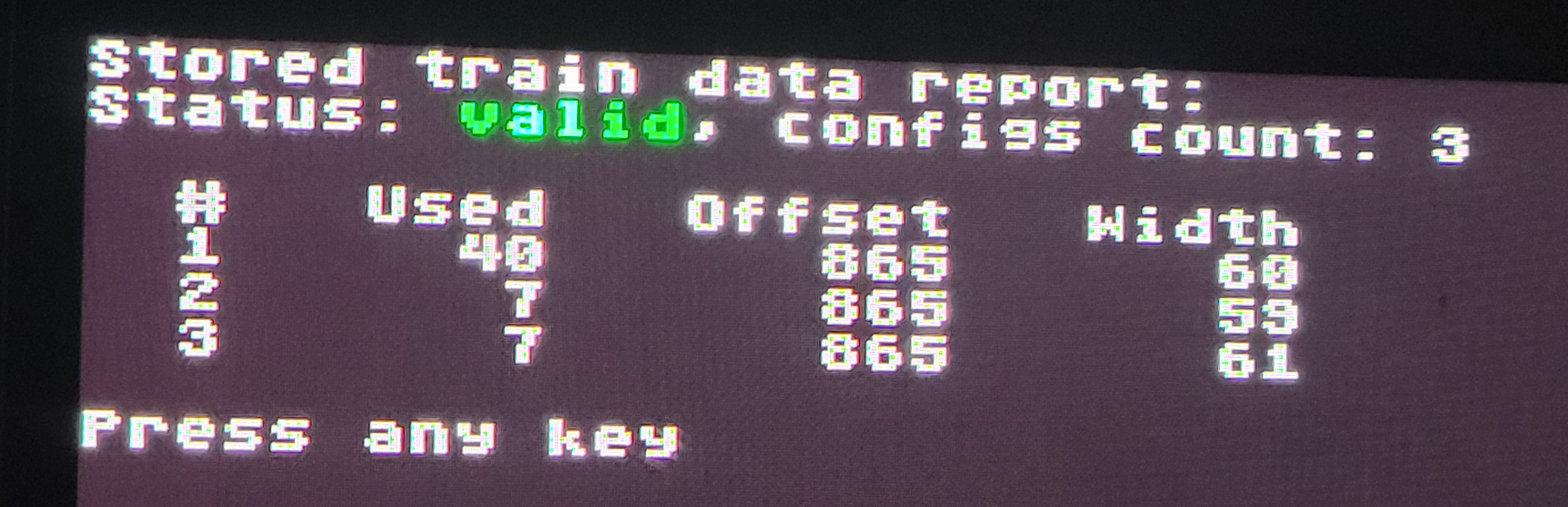

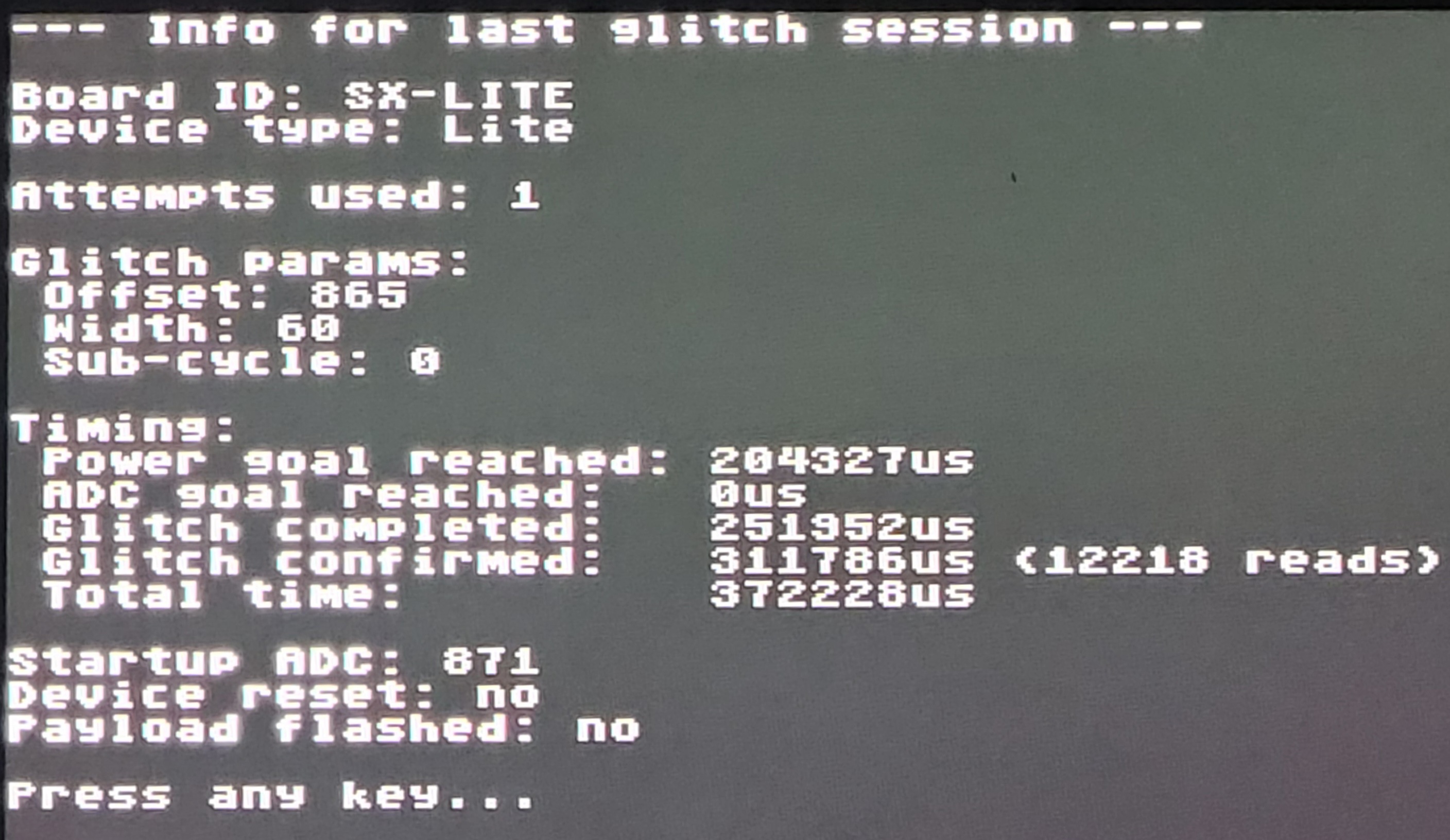

In order to get all the features it's most likely best to flash both the bootload & firmware on PC by hooking your chip up to your computer by USB.View attachment 299965View attachment 299966
