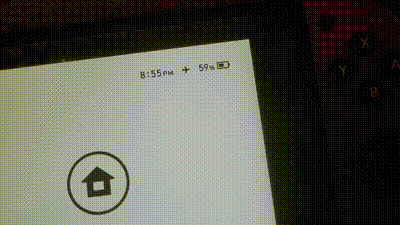

Yoo, booted up atmosphere on sysnand (latest firmware) to backup some saves and had this happens. Powered off and same thing in ofw. Charging it currently to see if any change occurs.
Edit: Seems like charging it fixed it. Weird bug though
Edit 2: Nope, my switch dropped from 100% to 10% within half an hour. Draining the battery to zero currently but it's lasting an awful long time while at 1%...

Had the same issue twice since i have my switch.
Do you have a trinket with fusee suite installed?
If yes, run the first 3x battery fix options from the trinket heklate mod.
(the last one is "fix fuel gauge" or simmilar).
This fixed the issue for me.
Good luck

Nope, I don't have a trinket. I do remember people having battery issues early on though with the solution of draining the battery to zero. Thanks though.
You get the battery calibration data damaged, make a full charge - discharge cycles 3 o 5 times and the battery meter will be established.
Ok. You can avoid the time consuming recharge cycles with reprogramming the battery calibration data like I mentioned.
Sadly, I don't know if there is an stand alone payload for this.
